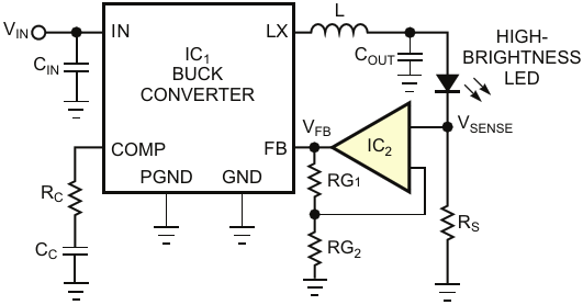

, increases the LED-current error signal and reduces power dissipation in the sense resistor

LED drivers minimize power dissipation

, provides constant-current drive for a high- brightness LED
Figure 3. Adjusting the feedback signal improves the efficiency in this buck-converter driver for high-brightness LEDs
