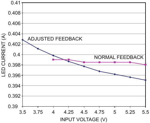

LED drivers minimize power dissipation
Figure 1. A generic buck converter, IC
1
, provides constant-current drive for a high- brightness LED
Figure 2. An op amp, IC
2
, increases the LED-current error signal and reduces power dissipation in the sense resistor
Figure 3. Adjusting the feedback signal improves the efficiency in this buck-converter driver for high-brightness LEDs
Figure 4. This graph shows LED current as a function of input voltage at half- load for the circuit of Figure 3
Figure 5. This graph shows LED current as a function of input voltage at full load for the circuit of Figure 3
Figure 6. A comparison of a normal-feedback circuit (Figure 1) and an adjusted- feedback circuit (Figure 3) shows significant improvements in overall efficiency at half-loads and at full loads
