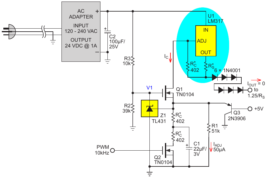

The 1-A, 15-V, PWM-programmed …
The 1-A, 15-V, PWM-programmed grounded-load current source with a novel LM317 topology. The asterisked resistors are 1% or better and R

PWM-programmed LM317 constant current source
Figure 1. Classic LM317 constant current source, I
OUT
= V
ADJ
/R
S
+ I
ADJ
≈ ≈ V
ADJ
/R
S
= 1.25/R
S
Figure 2. A novel LM317 topology enables control of amps of I
OUT
with just milliamps of I
C
, I
OUT
= (V
ADJ

≈ (V
ADJ
Figure 3. The 1-A, 15-V, PWM-programmed grounded-load current source with a novel LM317 topology. The asterisked resistors are 1% or better and R
S
= 1.25 Ω
Figure 4. I
OUT
versus D where D (x-axis) is the PWM duty factor and I
OUT
(y-axis) is V
ADJ
/1.25 = 1 A full-scale = 1 - 2/(1 + 1/D)
