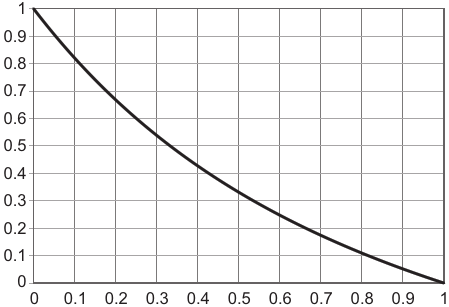

versus D where D (x-axis) is the PWM duty factor and I
OUT
(y-axis) is V
ADJ
/1.25 = 1 A full-scale = 1 - 2/(1 + 1/D)

Figure 5. D versus I
OUT
where I
OUT
(x-axis) is 1 A full-scale and D (y-axis) = 1/(2/(1 - I
OUT
) - 1)
