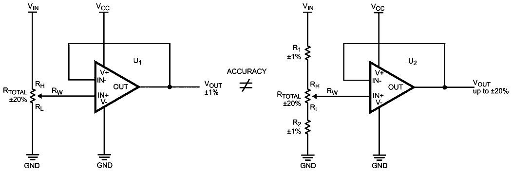

where, m is a current wiper position and n is a total number of taps. As can be seen from Equation 2, the resistance accuracy is canceled out and has no effect on VOUT. However, if a DCP has another resistor(s) on its RH and/or RL terminal, the accuracy of the output signal becomes a function of the initial accuracy of the DCP. This is because the scaled factor is not equal among the divider string, Figure 2.
| Figure 2. | Example of accuracy inequality. |
The output function for the circuitry with R1 and R2 in Figure 2 is as shown in Equation 3:
where n is the total number of taps and m is the current wiper position.
Note that wiper resistance is not included, because it has no effect in this particular configuration, assuming that we have an ideal Op Amp.

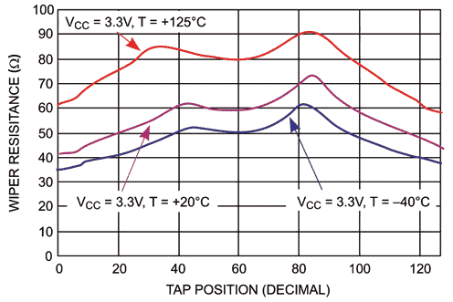

Another possible configuration is to leave one of the end terminals floating as in Figure 3B. In this case, the wiper resistance is well known and usually provided as a graph in a data sheet that makes calculation of total resistance at each tap much easier (Figure 4). Equation 4 can be used to calculate resistance at tap m
| Figure 4. | Wiper resistance vs tap position [ I(RW) = VCC/RTOTAL ] for 10kΩ (W). |
