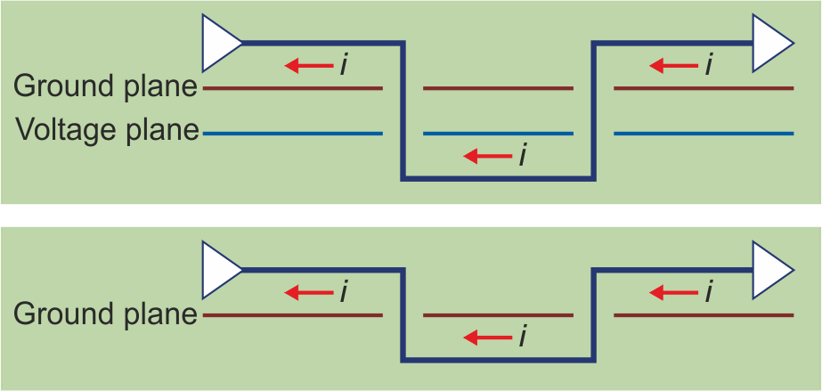

While there is no silver bullet to EMC, good design work should include the identification of parasitic EMI antennas, such as electric and magnetic dipoles. Also, identify the current paths, as current flows in loops and will always look for the path of least resistance. Accordingly, plan for a proper return path (noting that ‘ground’ is not an accepted technical term in EMC engineering) and avoid crossing splits/gaps (even for differential pairs) and return path discontinuities (see Figure 3).
EMC basics and practical PCB design tips
Figure 3. In the top diagram, the reference layer changes from the ground plane
to the voltage plane for part of the trace. This creates an EMI antenna.
Keeping with the same reference plane, as in the bottom diagram,
avoids/reduces return path discontinuities.
