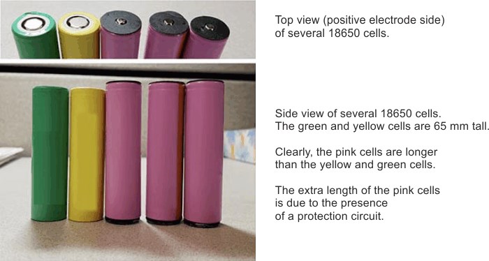

This design process is made possible because the cell is always 18 mm wide by 65 mm tall. They are a standard size, aren’t they? As it turns out, not all 18650 cells are 65 mm tall (Fig. 1).
The 18650 is shown with and without the protection circuit, revealing the detail of the protection circuit.
Figure 1. Shown are the various types of 18650 cells available.

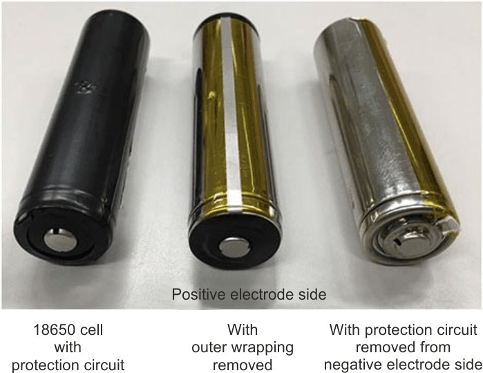

Some cells are taller because they contain a protection circuit. This protection circuit adds a few millimeters to the length of the cell, making it slightly taller than 65 mm. These cells are 18650 cells, so you would expect them to all be 65 mm tall. However, they clearly aren’t all the same size (Figs. 2 and 3).
Unwrapping an 18650 that includes a protection circuit.
Figure 2. Unwrapping an 18650 that includes a protection circuit.
In some applications, the 18650 cells are installed in a cell holder with spring-loaded contacts or flexible metal contacts. If there’s enough travel in these contacts, then the slightly larger “18650” will fit. But if the cell holder has tight tolerances, then this extra-long “18650” cell would not fit into the device.
