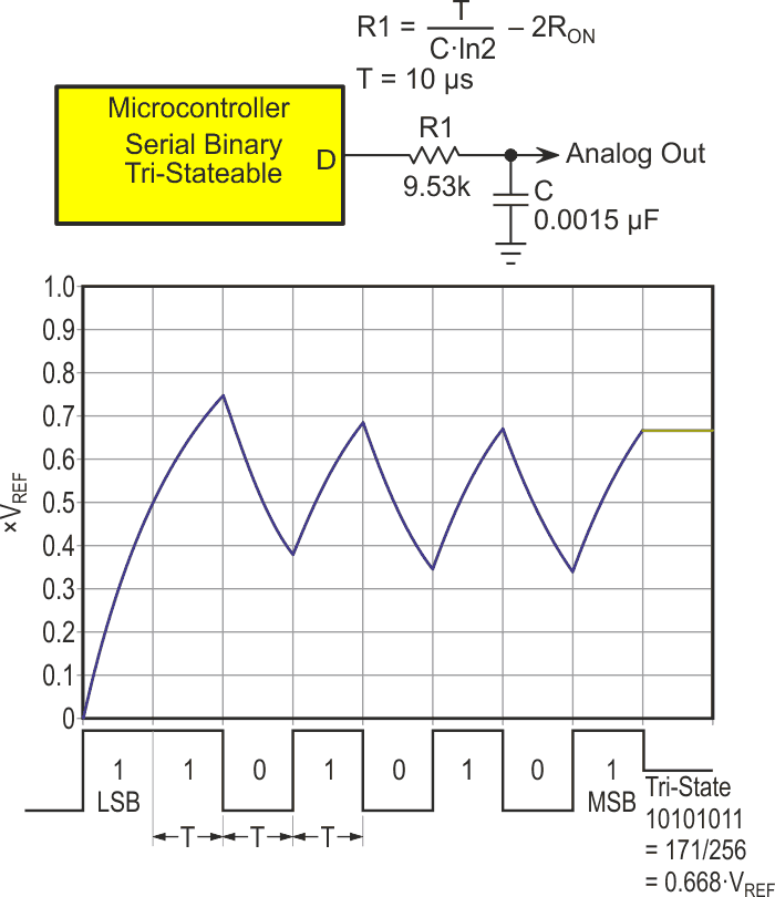

Figure 2 suggests what an 8-bit SD might look like using devices that have come along since 1948. Note that it closely resembles a basic PWM DAC, consisting only of a typical general-purpose output bit D and single-stage RC:
The RON term provides correction for ON resistance of the output port, typically 20 Ω to 200 Ω. We’ll see later why RON matters. Assuming an example 8 bit serial string = 10101011 = 171, T = 10 µs, C = 0.0015 µF, RON = 120 Ω, R = 9.53 kΩ, and VREF = 5 V logic supply, Analog Out (AO)
The required S&H function is provided at no cost by simply tri-stating D after Analog Out has been accumulated, allowing capacitor C to hold the final voltage and thus be its own S&H.

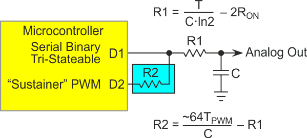

Some loads will tolerate this periodic disturbance, but many will not. Avoiding the glitch is possible, but to do so, parts count must increase. Figure 3 suggests one possible solution.
| Figure 3. | Supplementary PWM to prevent SD output droop. |
Supplementing the speed of the SD with a “sustainer” PWM set to the same output voltage as the SD to hold the same capacitor charge that was initially (quickly) set by the SD.
This solution is still less than perfect because the large ratio between the SD and PWM time constants implies a similarly large ratio between R1 and R2, imposing a high resistance for R2 to get adequate ripple suppression and hence, a very limited steady-state drive capability for Analog Out. And of course, there’s still an output glitch whenever an SD conversion sequence sets a new output voltage.

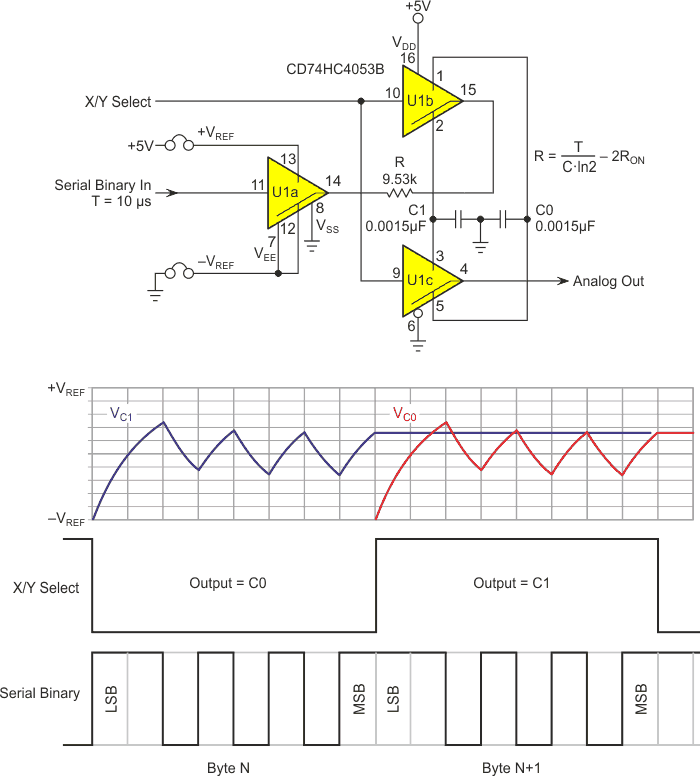

Figure 4 shows a complete remedy for these problems by implementing two S&H conversion/hold capacitors that toggle via U1c so that one provides the S&H function (C0/1 as X/Y Select = 0/1) and a constant output voltage while the other performs the next DAC conversion via U1a and U1b. Whereupon they switch roles, yada-yada and so on, etc.
| Figure 4. | The toggling SD. |
An additional feature of Figure 4’s topology is its ability to accept reference voltage inputs (+VREF, –VREF) that are independent of logic supply and ground. This allows for better DAC accuracy than relying on the (typically limited) stability of logic power supplies, and, if –VREF is negative, a bipolar (–VREF to +VREF) output span.
