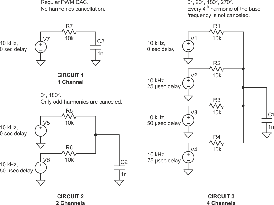

Let’s say we decided to use n channels at f Hz, if each consecutive PWM channel has 1/(f•n) delay (or 360/n phase shift) with respect to each other then every harmonic components is going to be cancelled because of evenly spaced time delays except for every nth harmonic. To be clearer, let’s say we’re using 10 kHz as our main PWM frequency and we implement four channels with 25 µs time delay (90-degree phase shift). In that case, the first channel is our base channel and it doesn’t have delay; the second channel has 25 µs delay (90-degree) with respect to the base channel; the third channel has 50 µs delay (180-degree) with respect to the base channel; and the last channel has 75 µs delay (270-degree) with respect to the base channel.
As stated earlier each consecutive channel has 25 µs (1/(f•n), f = 10 kHz, n = 4) delay with respect to its “neighboring” channel. This circuit is shown in Figure 1 along with the one-channel and two-channel versions.
The four-channel phased-array PWM DAC circuit along with the one- and two-channel versions.
Figure 1. The four-channel phased-array PWM DAC circuit along with the one- and two-channel versions.
The output of this four-channel PWM DAC is going to contain only the 4th harmonic of the base PWM frequency, and as a result the output is going to contain no ripple when the duty cycle is 25%, 50% or 75% because those PWM signals have no 4th harmonic content.
