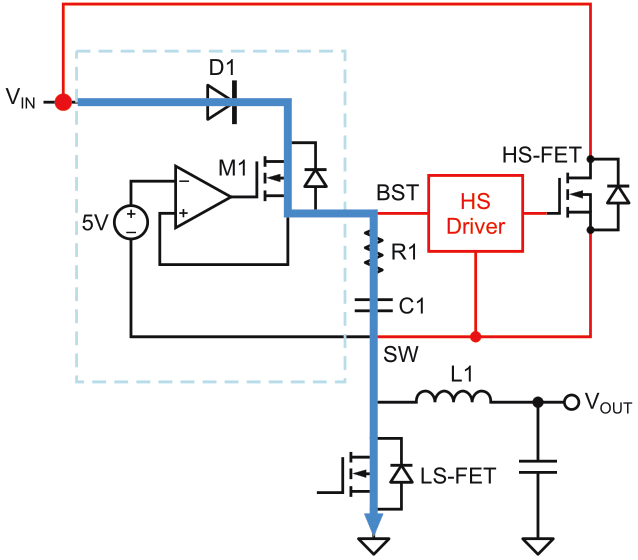

Consider a buck circuit as an example. To drive the high-side MOSFET (HS-FET) and ensure that the gate-to-source voltage (VGS) exceeds the threshold voltage (VTH), a bootstrap circuit may be required to raise the gate’s voltage.
Figure 2 shows that C1 completes the charging and discharging process within one switching cycle, which raises the gate voltage. Charge pumps are not only used by a buck converter’s bootstrap circuit to drive the HS-FET. Charge pumps can also be used to drive the HS-FET in half-bridge and full-bridge applications.

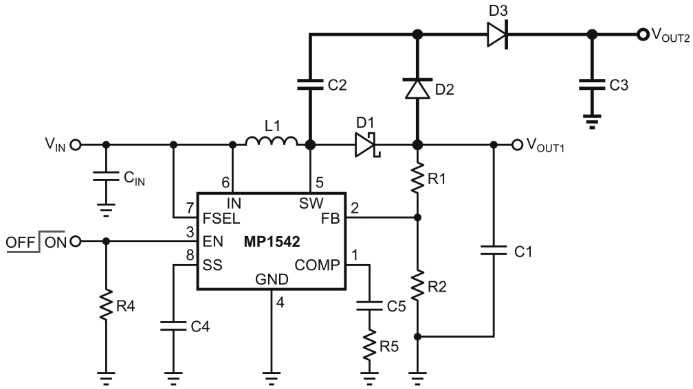

For boost applications, the boost converter’s maximum VOUT may not be able to meet the voltage specifications for certain devices, such as the VP/VN power supply in TFT-LCDs. Consider a converter that is commonly used for TFT-biased power supplies. If the output exceeds 25 V but the SW pin only supports up to 25 V, then the output is often limited.
Engineers could find an IC that can withstand higher voltages, but those ICs are less cost-effective. In this scenario, a charge pump circuit can be added (see Figure 3). With a few additional components, the boost converter has a new output (VOUT2) that is double that of the typical output voltage (VOUT1). Figure 3 shows a charge pump being used by the MP1542, a 700 kHz/ 1.3 MHz boost converter.

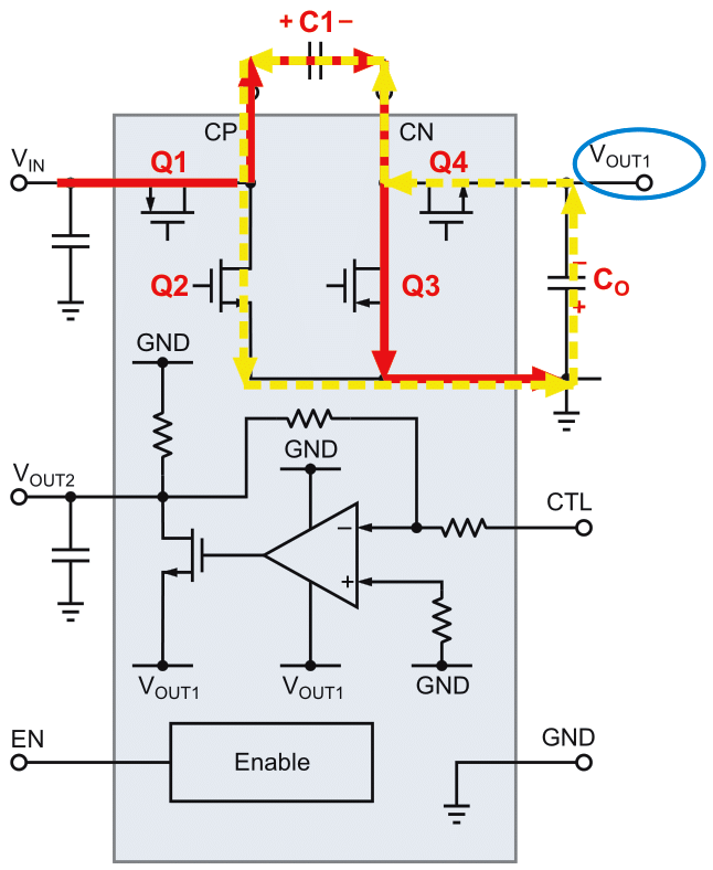

Figure 6 shows a circuit that only needs 4 MOSFETs in the internal logic circuit so that VOUT is equal to –VIN. This circuit does not need external inductors, which reduces overall cost and simplifies the design. This compact, low-profile solution is suitable for a wide range of applications, including optical modules, RF amplifiers, and sensor power supplies.
