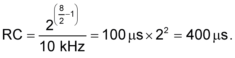

The minimum RC time-constant required to attenuate ripple to no more than 1 least significant bit (lsb) for any given N = number of PWM bits of resolution and TPWM = PWM period is given by:
For example, for N = 8, FPWM = 10 kHz
