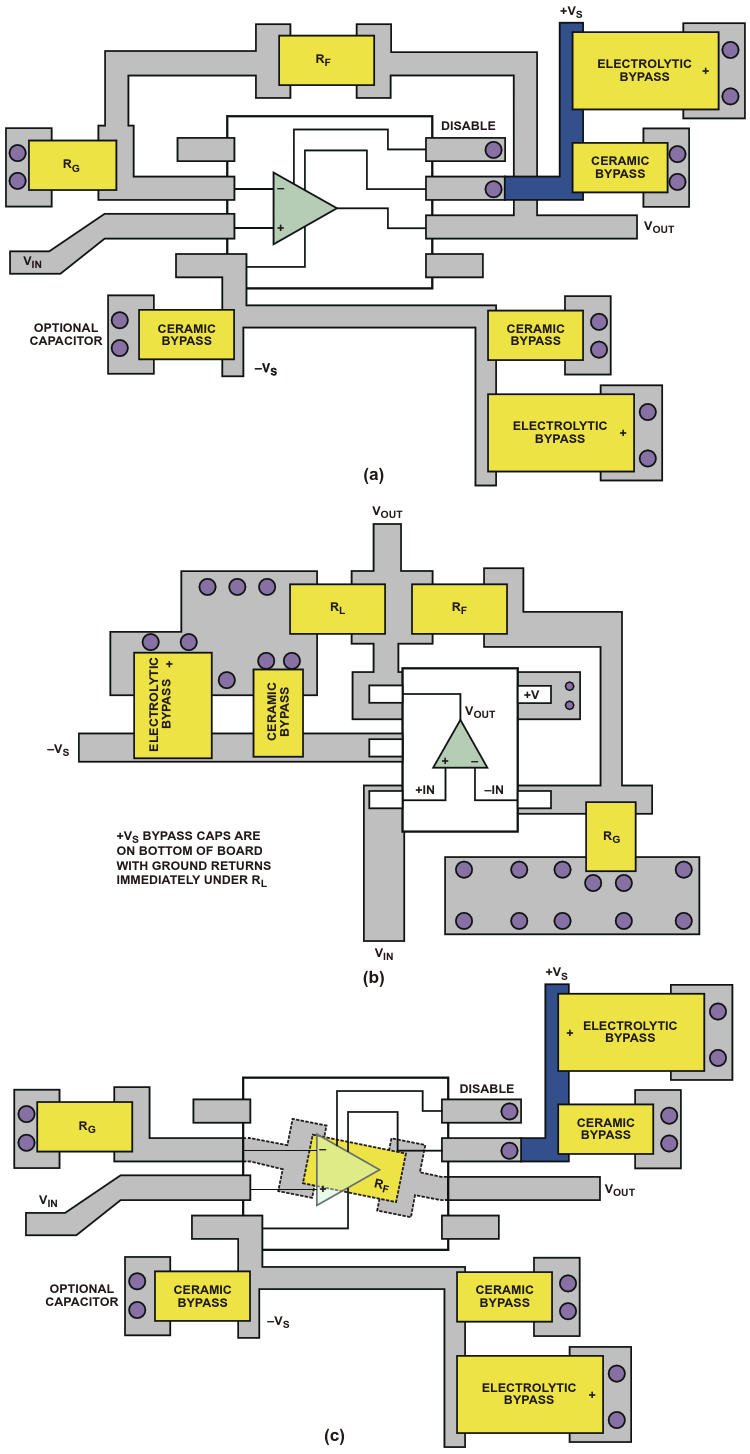

Layout differences for an …
Layout differences for an op-amp circuit. (a) SOIC package, (b) SOT-23, and (c) SOIC with RF underneath board

A Practical Guide to High-Speed Printed-Circuit-Board Layout. Part 2
Figure 9. Layout differences for an op-amp circuit. (a) SOIC package, (b) SOT-23, and (c) SOIC with RF underneath board
