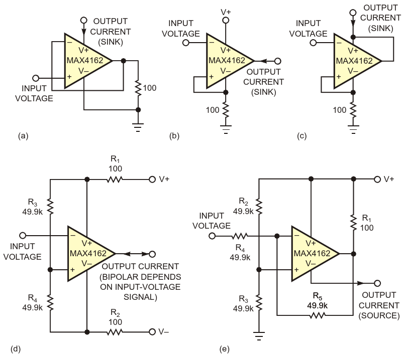

This compendium of constant-current …
This compendium of constant-current circuits includes current sinks (a, b, and c), a bipolar sink or source (d), and a current source (e)

Op amp can source or sink current
Figure 1
Figure 1. This compendium of constant-current circuits includes current sinks (a, b, and c), a bipolar sink or source (d), and a current source (e)
