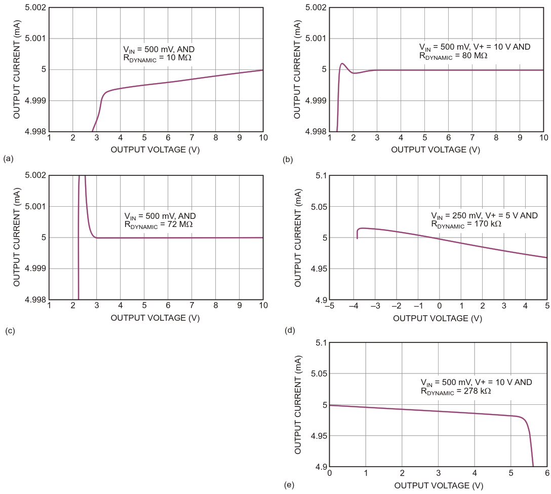

These graphs show output current versus output-voltage characteristics for the circuits in Figure 1. Note that for b and c, the dynamic-output-impedance characteristic closely resembles that of an ideal current source: ΔVOUT/ΔVIN = ∞
Figure 2. These graphs show output current versus output-voltage characteristics for the circuits in Figure 1. Note that for b and c, the dynamic-output-impedance characteristic closely resembles that of an ideal current source: ΔVOUT/ΔVIN = ∞
