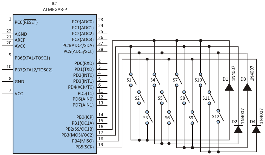

The 12-switch arrangement can …
The 12-switch arrangement can be used to interface a numeric keypad to a microcontroller, in this case, an ATmega8

Figure 3. The 12-switch arrangement can be used to interface a numeric keypad to a microcontroller, in this case, an ATmega8
