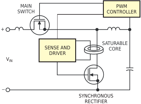

A low-cost, saturable core in the drain circuit of the synchronous rectifier introduces a "self-timing" feature in the circuit
Giampaolo Carli
Method provides self-timing for synchronous rectifiers

Figure 1. These topologies often exhibit a delayed turn-off of the synchronous rectifier, resulting in considerable reverse current. The current-reversal timing depends on loading conditions (a). The zero-cross current causes the rectifier to turn off too late (b)
Figure 2. A low-cost, saturable core in the drain circuit of the synchronous rectifier introduces a "self-timing" feature in the circuit
