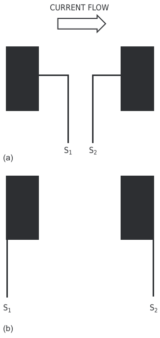

Conventional solder pads offer two choices for Kelvin connections: on the pads' inner edges (a) or outer corners (b)

Improved Kelvin contacts boost current-sensing accuracy by an order of magnitude
Figure 1. Conventional solder pads offer two choices for Kelvin connections: on the pads' inner edges (a) or outer corners (b)
Figure 2. Modified pads provide isolated Kelvin connections that eliminate errors introduced by voltage drops across soldered connections carrying high current
