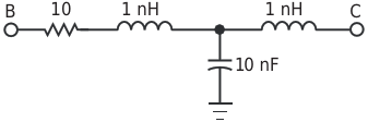

This circuit represents a …
This circuit represents a simulated transmission line inserted between points A and B of the circuit in Figure 1

Figure 2. This circuit represents a simulated transmission line inserted between points A and B of the circuit in Figure 1
