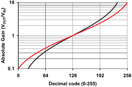

Two added resistors limits gain to recommended 0.1 to 10 range without sacrificing resolution. The red curve shows the result

Figure 1. Amplifier with Dpot pseudologarithmic gain control that runs away at zero and 28
Figure 2. Pseudologarithmic gain goes off the chart for codes below 24 and above 232
Figure 3. Add two fixed resistors to bound the gain range to the recommended limits while keeping full 8-bit resolution
Figure 4. Two added resistors limits gain to recommended 0.1 to 10 range without sacrificing resolution. The red curve shows the result
