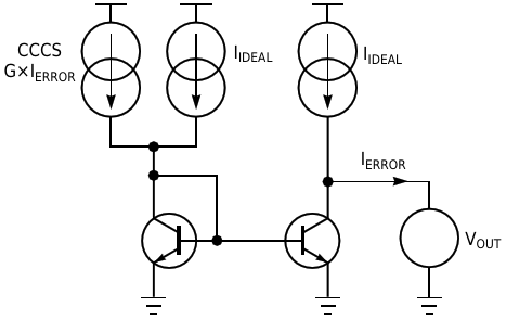

Use this circuit for simulation of current-mirror input-offset currents
Johan Bauwelinck
Simulate input-offset current for current mirrors
Figure 1
9 Kb
Figure 1. Use this circuit for simulation of current-mirror input-offset currents
Figure 2. This bar graph shows the input offset-current distribution
