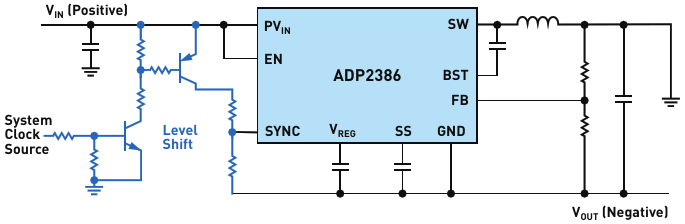

External level shifter for supplying the switching regulator IC with an external clock for synchronization

Generating negative voltages - why you need level shifting in buck-boost circuits
Figure 1. An inverting buck-boost topology for generating a negative voltage with a step-down (buck) switching regulator
Figure 2. External level shifter for supplying the switching regulator IC with an external clock for synchronization
