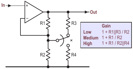

An on/off/on switch gives three gain settings in a non-inverting amplifier stage and does so in a rational order
Nick Cornford
Ternary gain-switching 101 (or 10202, in base 3)

Figure 1. An on/off/on switch gives three gain settings in a non-inverting amplifier stage and does so in a rational order
