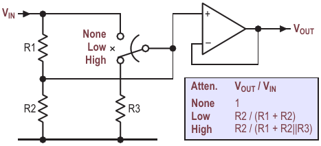

Ternary gain-switching 101 (or 10202, in base 3)

Figure 4. A single attenuation stage with three switchable levels
