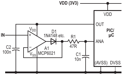

The basic peak-hold circuit. The PIC pin labelled ANA samples the voltage on C1 and then resets it to ground, ready for the next sample

Figure 1. The basic peak-hold circuit. The PIC pin labelled ANA samples the voltage on C1 and then resets it to ground, ready for the next sample
Figure 2. Boosting the op-amp's supply rails can give true rail-to-rail operation while an extra MOSFET allows "instantaneous" resetting of C1
