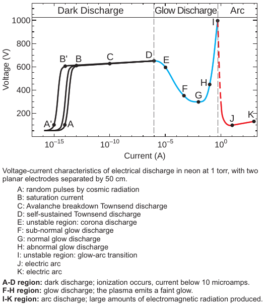

This detailed view of …
This detailed view of the three discharge zones shows some subtle effects and transition points

Figure 6. This detailed view of the three discharge zones shows some subtle effects and transition points
