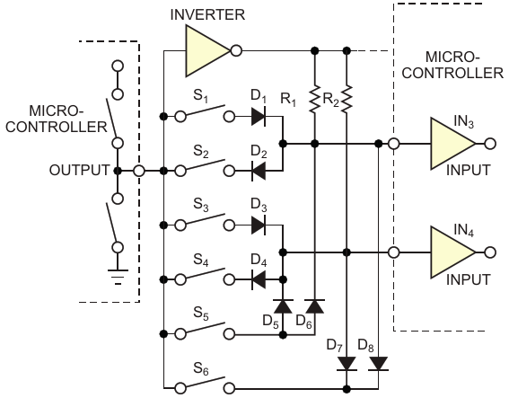

You can use this circuit to reduce the number of inputs coding the switches
Jean-Bernard Guiot
Active multiplexing saves inputs
Figure 3
14 Kb
Figure 1. The controlling output in this circuit uses two switches
Figure 2. The controlling output in this circuit uses two switches
Figure 3. You can use this circuit to reduce the number of inputs coding the switches
