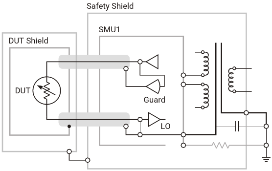

Understanding grounding, shielding, and guarding in high-impedance applications. Part 2

Figure 5c. With a single SMU, grounding the shield with a resistor, at the instrument leads to no error current in the measurement LO lead
