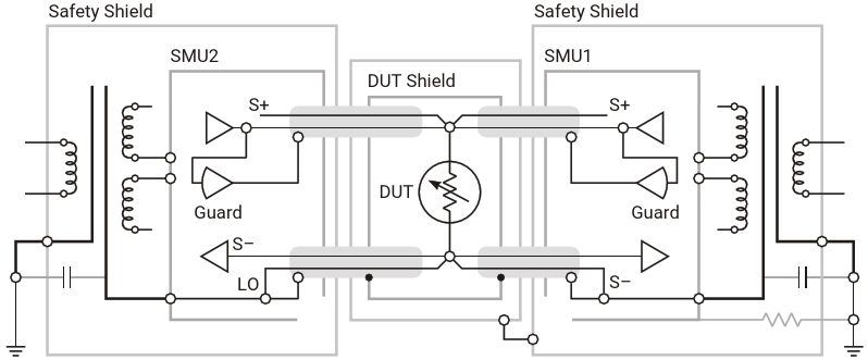

With two SMUs, the …
With two SMUs, the remote sense lines compensate for the current flowing in the measurement leads generated from the use of two different grounds

Figure 5d. With two SMUs, the remote sense lines compensate for the current flowing in the measurement leads generated from the use of two different grounds
