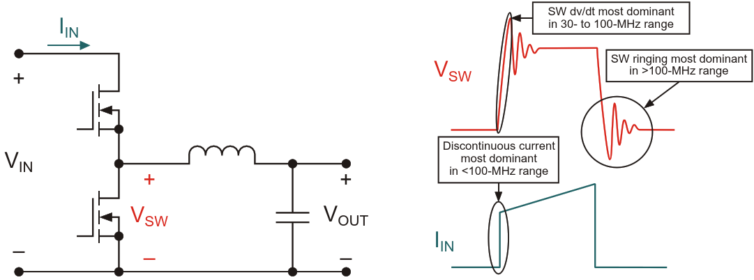

This schematic shows the EMI sources in an SMPS. (Image from Reference 8)

Figure 1. This schematic shows the EMI sources in an SMPS. (Image from Reference 8)
