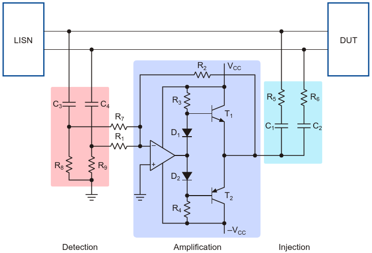

This high-performance filter design, …
This high-performance filter design, with no magnetic components, can support high output currents in the order of 60 A. (Image from Reference 7)

Figure 4. This high-performance filter design, with no magnetic components, can support high output currents in the order of 60 A. (Image from Reference 7)
