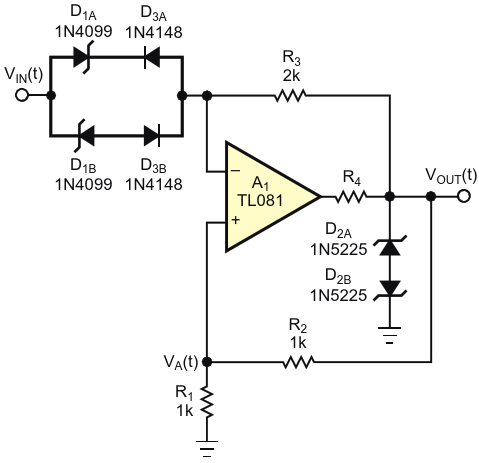

Figure 3. This circuit achieves dual hysteresis using only one op amp
