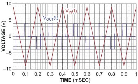

This oscilloscope trace shows the response of the circuit in Figure 3 to a triangular input waveform

Single Op Amp Achieves Double-Hysteresis-Transfer Characteristic

Figure 5. This oscilloscope trace shows the response of the circuit in Figure 3 to a triangular input waveform
