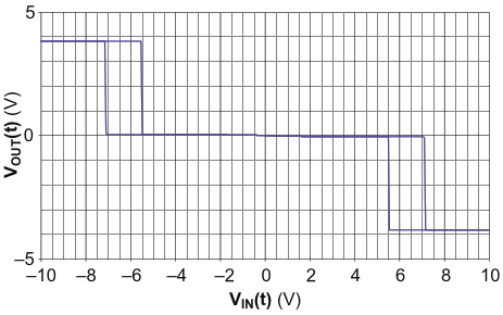

This oscilloscope trace shows …
This oscilloscope trace shows the transfer characteristic of the circuit in Figure 3
Herminio Martinez, Encarna García, Juan Gámiz
Single Op Amp Achieves Double-Hysteresis-Transfer Characteristic
Figure 4
213 Kb
Figure 1. One straightforward way of obtaining a double-hysteresis-transfer characteristic uses three op amps with voltage references and zener diodes
Figure 2. The I/O-transfer characteristic of the circuit in Figure1 exhibits two hysteresis bands
Figure 3. This circuit achieves dual hysteresis using only one op amp
Figure 4. This oscilloscope trace shows the transfer characteristic of the circuit in Figure 3
Figure 5. This oscilloscope trace shows the response of the circuit in Figure 3 to a triangular input waveform
