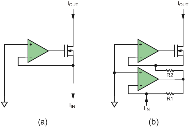

Figure 6. (a) Inverting low Z
IN
current mirror, and (b) noninverting low Z
IN
current mirror
