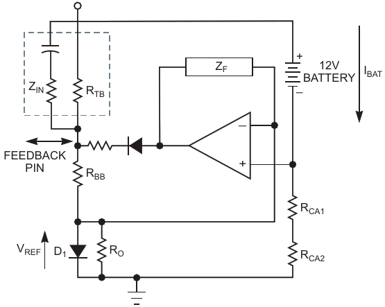

The second stage comprises a SEPIC that operates in boost mode with constant current-charge control and charges the 12 V battery

Figure 8. The second stage comprises a SEPIC that operates in boost mode with constant current-charge control and charges the 12 V battery
