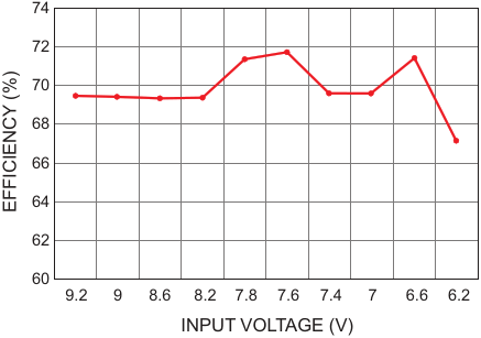

Efficiency falls off rapidly …
Efficiency falls off rapidly when the input voltage from the solar panel falls below 6.5 V

Figure 11. Efficiency falls off rapidly when the input voltage from the solar panel falls below 6.5 V
