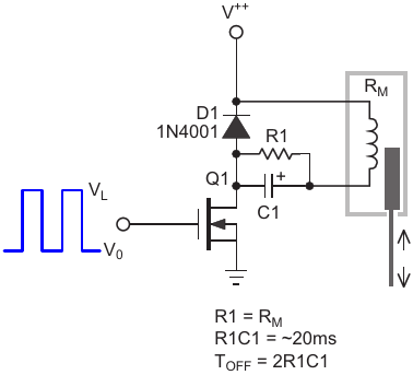

Basic driver circuit where C1 actuates, current-halving R1 sustains, then C1 discharges through R1 during T

Relay and solenoid driver circuit doubles supply voltage to conserve sustaining power
Figure 1. Basic driver circuit where C1 actuates, current-halving R1 sustains, then C1 discharges through R1 during T
