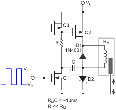

Q1 and Q2 cooperate …
Q1 and Q2 cooperate with C to double V
L
for actuation, Q2 and D2 sustain, then Q3 rapidly discharges C through R to quickly recover for the next cycle

Relay and solenoid driver circuit doubles supply voltage to conserve sustaining power

Figure 2. Q1 and Q2 cooperate with C to double V
L
