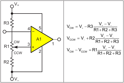

The bad: Attenuation of …
The bad: Attenuation of the supply voltages is done with subtraction instead of division, destroying the PSRR of the amplifier

The good, the bad, and the ugly of zero trims
Figure 1. The bad: Attenuation of the supply voltages is done with subtraction instead of division, destroying the PSRR of the amplifier
Figure 2. The ugly: An attempt to correct for the destroyed PSRR can be done by achieving attenuation with a voltage divider instead; however, the supply rails must be symmetrical, leading us back to our PSRR problem
Figure 3. The good: Setting R2 = R3(-V
/ V
)/2 to get a symmetrical trim range
