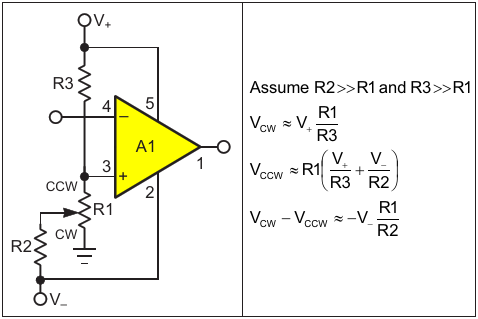

The good, the bad, and the ugly of zero trims
Figure 3
13 Kb
Figure 1. The bad: Attenuation of the supply voltages is done with subtraction instead of division, destroying the PSRR of the amplifier
Figure 2. The ugly: An attempt to correct for the destroyed PSRR can be done by achieving attenuation with a voltage divider instead; however, the supply rails must be symmetrical, leading us back to our PSRR problem
Figure 3. The good: Setting R2 = R3(-V
/ V
)/2 to get a symmetrical trim range
