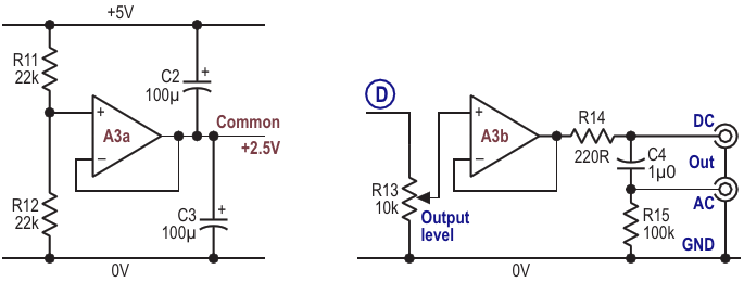

A simple rail-splitter to derive the 2.5-V "common" rail, and an output level control and buffer with both AC- and DC-coupled outputs

Figure 4. A simple rail-splitter to derive the 2.5-V "common" rail, and an output level control and buffer with both AC- and DC-coupled outputs
