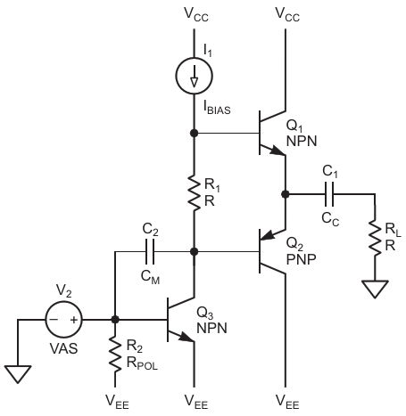

The capacitor-coupled output's cut-off …
The capacitor-coupled output's cut-off low frequency is determined by the load, the capacitor C
C
, and the output network

Figure 1. The capacitor-coupled output's cut-off low frequency is determined by the load, the capacitor C
C
