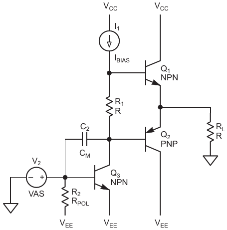

Temperature drift compensation for audio power amplifiers

Figure 2. The directly-coupled output's lower cut-off frequency is not limited by the output
Figure 3. Here is a simple model of the amplifier
Figure 4. This simplified model of a VAS and driver will provide us with valuable insights about the output DC offset
Figure 5. This is a first-order real-world implementation of the circuit
