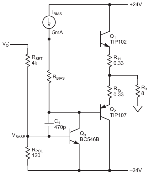

Figure 5. This is a first-order real-world implementation of the circuit
