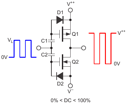

Driving CMOS totem poles with logic signals, AC coupling, and grounded gates
Figure 3
9 Kb
Figure 1. The simplest case of logic signal totem pole drive - direct connection works if V
<= V
L
Figure 2. AC coupling can solve the problem of positive rail voltage mismatch if the control signal runs continuously
Figure 3. Ditto for AC coupling and negative rail mismatch, too
Figure 4. "Grounded" gate Q3 maintains C1 charge when logic signal stops
Figure 5. Grounded gate Q4 shifts logic signal to negative rail referred C2 and Q2
