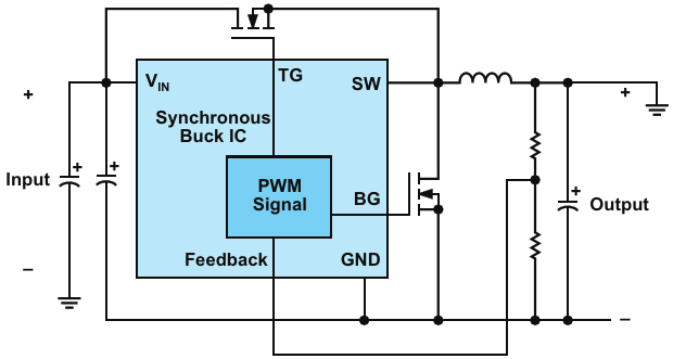

A buck IC used in an inverting buck-boost topology

Figure 4. A buck IC used in an inverting buck-boost topology
