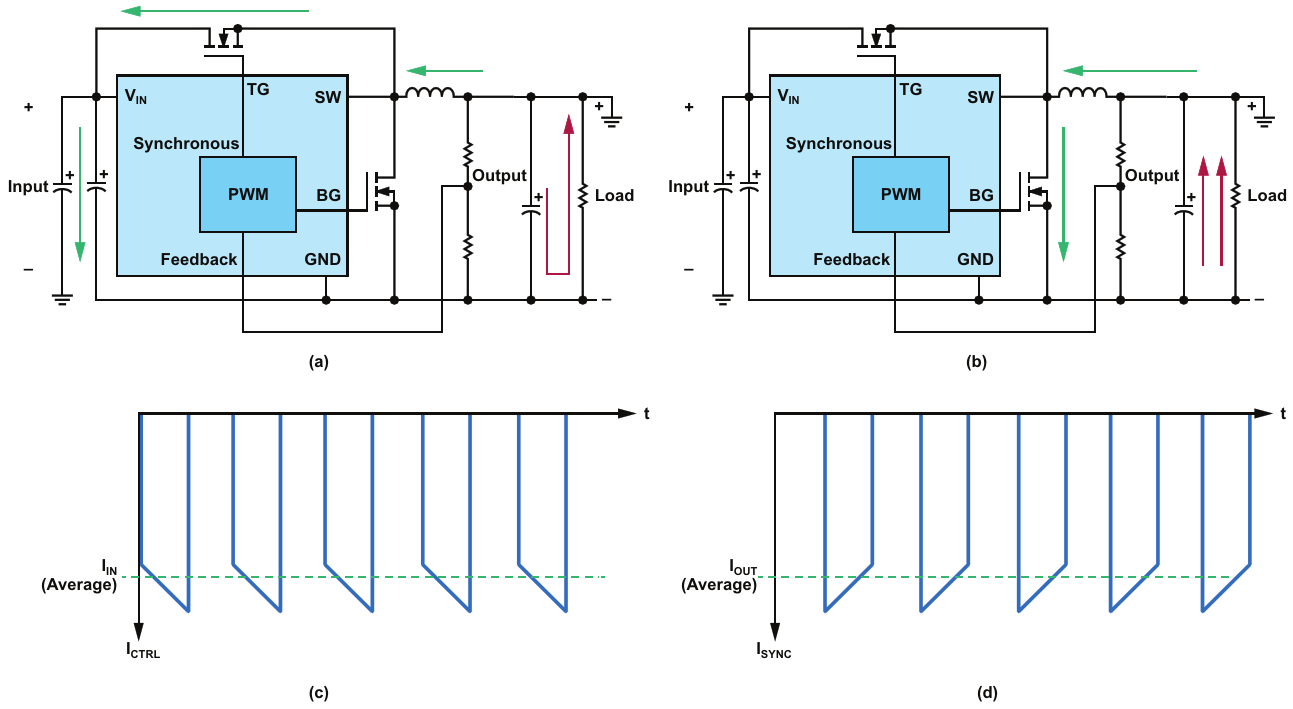

(a) Current flow during on-time, (b) current flow during off-time, (c) current through the top/control MOSFET (ICTR), and (d) current through the bot/sync MOSFET(ISYNC)
AuthorsAnthony Serquiña, Jhun Rennel Sanchez
Main DocumentArticle «How to create a dual-output voltage rail with source and sink functionality for ATE applications»
DescriptionFigure 6
File Format / SizePDF / 20 Kb
(a) Current flow during on-time, (b) current flow during off-time, (c) current through the top/control MOSFET (I sub CTR /sub ), and (d) current through the bot/sync MOSFET(I sub SYNC /sub )
