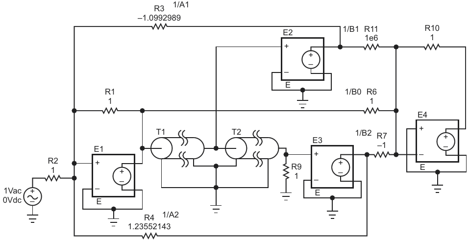

In the PSpice circuit, the VCVSs (voltage-controlled voltage sources), E1 and E2, simulate voltage followers, and VCVSs E3 and E4 and the resistors that connect to them simulate summers
