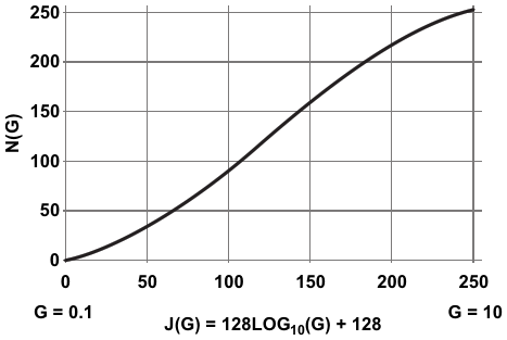

The Dpot settings [N(J)] …
The Dpot settings [N(J)] versus log table indices [J(G)], summarizing the relationship between G, J, and N

Dpot pseudolog + log lookup table = actual logarithmic gain

Figure 1. Two fixed resistors are added to bound the gain range to the recommended limits while keeping full 8-bit resolution
Figure 2. Somewhat improved pseudologarithmic gain curve from the simple modification shown in Figure 1
Figure 3. The Dpot settings [N(J)] versus log table indices [J(G)], summarizing the relationship between G, J, and N
Figure 4. The absolute gain [G
ABS
= 10(J/128 -1)] versus decimal code (J)
