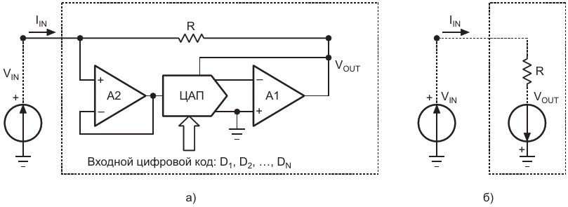

Figure 2. a) Programming the DAC's output voltage changes R
EQ
, which can balance a bridge circuit. b) Equivalent circuit
